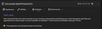

Can't enable fast lane on p41 plus

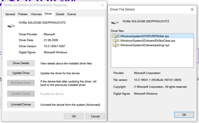

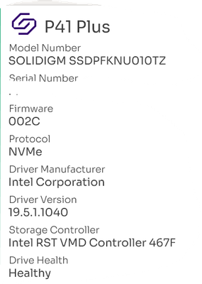

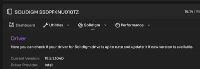

And in the driver section it says its from intel.
Its mounted on a PCIe3

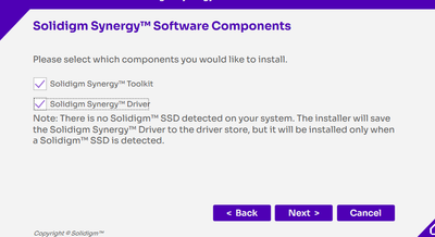

1. Verify the Correct Driver is Installed
- Download the latest version of Solidigm Synergy™ Driver: The Fast Lane feature requires the Solidigm Synergy™ driver, not the default Intel driver.
- Check Device Manager: Go to Device Manager, locate your SSD under "Disk Drives," and check the driver details. If it still shows Intel, you may need to manually update the driver by selecting "Update Driver" and pointing it to the Solidigm driver you downloaded.

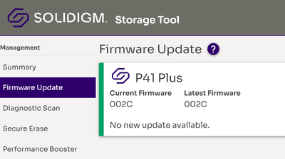

2. Update the Solidigm Storage Tool
- Ensure Latest Version: Make sure you're running the most recent version of the Solidigm Storage Tool.
- Reinstall the Tool: If the tool is already up to date, try uninstalling it and then reinstalling to ensure it's properly configured.

I reinstalled both apps, updated windows and I'm pretty sure csm is disabled. I tried to update the drivers manually but I can't find where the drivers are downloaded.
