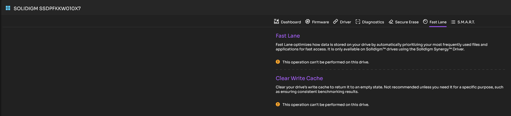

fast lane can't be performed on P44 Pro
10-13-2023 12:58 PM
Just installed a 1Tb P44 Pro on my system. The tab Fast Lane states: This operation can't be performed on this drive.
Why is this happening?
Thank you for your help,
Kind regards, Peter
10-16-2023 03:51 PM
HI, pjthys
Thank you for contacting us, regarding your question:
"Fast lane can't be performed on P44 Pro"
This feature is not suitable for P44 Pro.
Fast Lane, previously known as Host-Managed Caching, is supported on the Solidigm P41 Plus, this can be found in the user guide 3.1 Fast Line section.
Please let me know if you have more questions.
Regards
