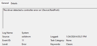

I upgraded to the Solidigm P41 Plus (SSDPFKNU020TZ) a few months back as my primary system/boot drive. Since then my Windows 11 system will randomly crash and restart. I do not see a BSOD. It is intermittent and doesn't matter if the computer is under heavy use, or just chilling after a fresh reboot. I've seen it crash in both (and several other) scenarios.
I am running the latest firmware and drivers, but continue to have this issue. No issues are found with the drive, and I suspect it might be driver related as the Event Viewer is full of errors. (see below)
Curious if anyone else has had this problem and/or if they might have a useful work around.

Many people have this problem but S0lidigm does not want to solve it. I have the same drive, but luckily I don't use it as a system drive, so I only have errors in the event viewer.
07-07-2024 06:16 AM

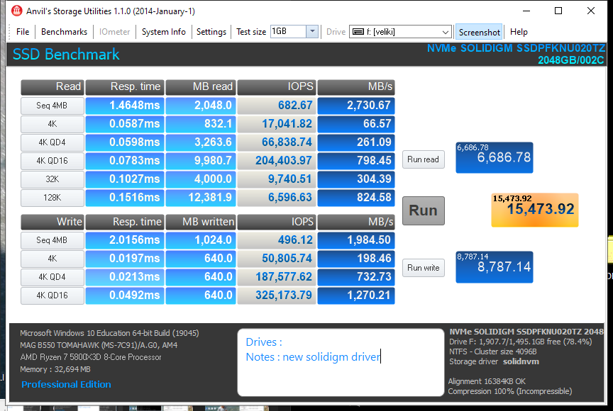

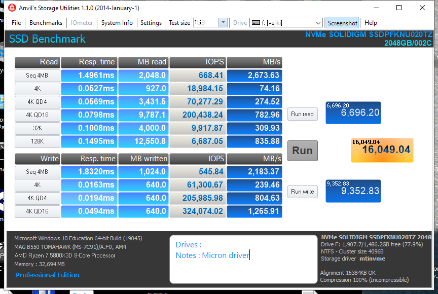

I tested new driver v. 2.3.0.1023 and I still have that error in event viewer id 11 but this new driver is slower than previous v.2.2.0.1017. Micron driver is best and error free. Solidigm need to fix this problem with new firmware update.

Do you have an explanation why the new v.2.3.0.1023 drivers are slower than the previous v.2.2.0.1017 and are you working on a fix for the bug that is reported in the event viewer Event ID = 11?
Thank you in advance

Sometimes, drivers might not be as optimized for certain hardware configurations, which can result in slower performance. Also, the issue with Event Viewer Event ID = 11 can be related to many things, including hardware issues, firmware problems, or indeed bugs within the driver itself.
