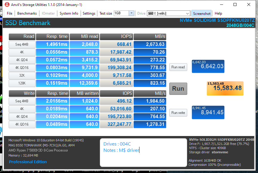

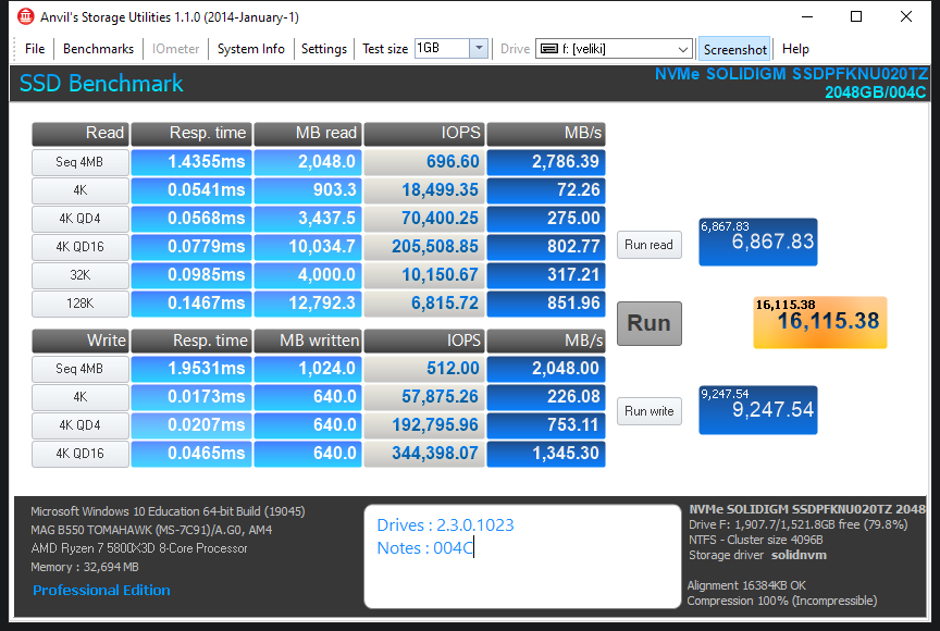

I want to inform you that the last FW 004C from Solidigm™ Storage Tool (For Data Center And Legacy Client SSDs) did not solve the event id 11 problem 😐

Thank you for your feedback. I would like to inform you that the drives of the P41 series are not EOL.
If the latest firmware update (004C) does not resolve your issue, we recommend using a Microsoft driver.

Thanks for the advice, but I'll stick to the micron driver.
