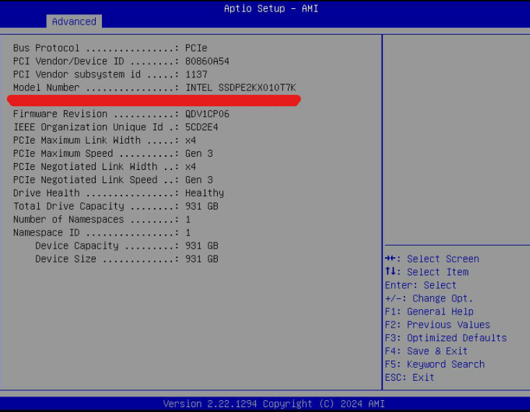

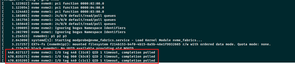

I've a Supermicro bladeserver (AS -3015MR-H8TNR), It's AM5 platform with a EPYC 4545 CPU installed with 48G RAM. Now the issue is whenever the 'intel P4500 SSDs' are installed in the U.2 bays, the installation of any linux OS just hangs and the error is displayed in the images attached as well.SSD detailsSSD detailsErrors faced while installing which stalls the whole processErrors faced while installing which stalls the whole process
[  448.627117] nvme nvme2: I/O tag 448 (31c0) QID 1 timeout, completion polled
[  478.835271] nvme nvme1: I/O tag 960 (b3c0) QID 2 timeout, completion polled
[  478.835295] nvme nvme2: I/O tag 449 (c1c1) QID 1 timeout, completion polled

  4. Check the firmware.
    The firmware revision (QDV1CP06) appears to be a Cisco OEM version, which may differ from the generic Intel retail release. If this drive came from a Cisco system, firmware updates and support would need to be handled through Cisco directly.

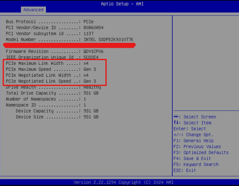

Also, please make sure in the BIOS that:
  • PCIe speed is set to Gen3 (not Auto)
  • ASPM is disabled
If the issue continues, it will be good to check with Supermicro for any known compatibility or BIOS updates for the U.2 ports.

PCIe Link SettingsPCIe Link SettingsASPM Support DisabledASPM Support Disabled

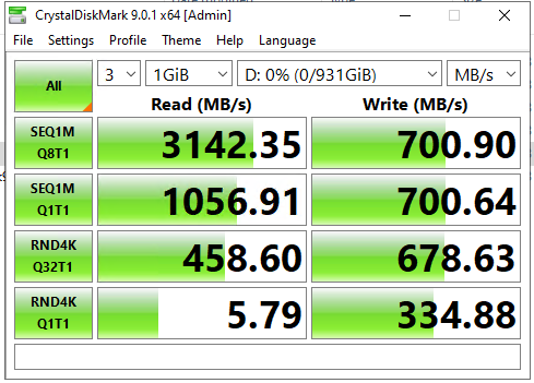

Moreover, I've taken READ/WRITE benchmarks as well for the drive.
Benchmark from WindowsBenchmark from Windows

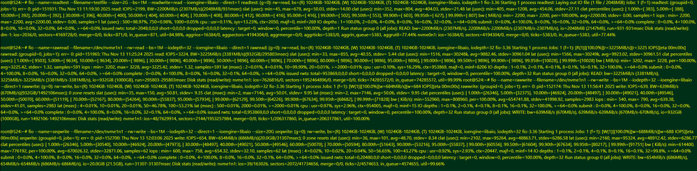

Also before proceeding for Windows installation, I was able to get the disk benchmarks from the Linux (The Linux that was previously installed was done by removing the Intel U.2 drives, installing on M.2 NVMe onboard and plugging the drives back and reboot).
Benchmark from LinuxBenchmark from Linux
