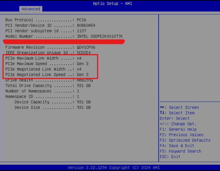

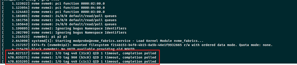

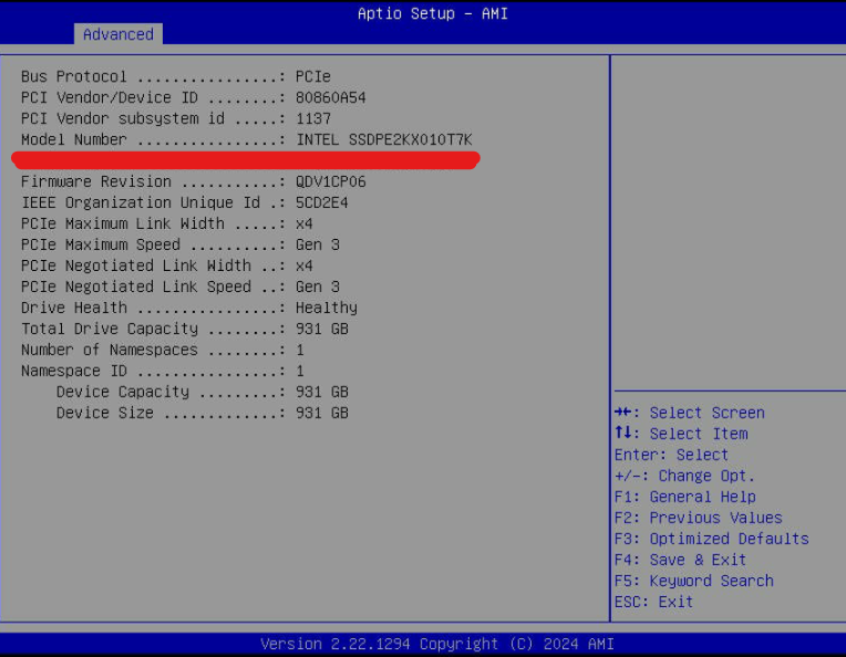

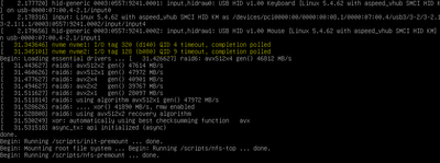

I've a Supermicro bladeserver (AS -3015MR-H8TNR), It's AM5 platform with a EPYC 4545 CPU installed with 48G RAM. Now the issue is whenever the 'intel P4500 SSDs' are installed in the U.2 bays, the installation of any linux OS just hangs and the error is displayed in the images attached as well.SSD detailsErrors faced while installing which stalls the whole process
[  448.627117] nvme nvme2: I/O tag 448 (31c0) QID 1 timeout, completion polled
[  478.835271] nvme nvme1: I/O tag 960 (b3c0) QID 2 timeout, completion polled
[  478.835295] nvme nvme2: I/O tag 449 (c1c1) QID 1 timeout, completion polled

Thank you for sharing the detailed information and screenshots.

    The firmware revision (QDV1CP06) appears to be a Cisco OEM version, which may differ from the generic Intel retail release. If this drive came from a Cisco system, firmware updates and support would need to be handled through Cisco directly.

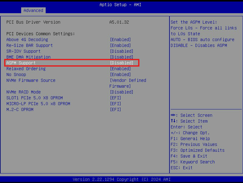

Hi nightwings3,
Thank you for the update.
About the firmware — since your P4500 drives are using OEM firmware (likely Cisco), it is not possible to flash them with the generic Intel/Solidigm firmware. Using the wrong firmware could stop the drive from working, so we cannot provide it.
Please let us know the results once you try installing Windows. This will help us confirm if the issue is related to the system or the OS.
Also, please make sure in the BIOS that:
  • PCIe speed is set to Gen3 (not Auto)
  • ASPM is disabled
If the issue continues, it will be good to check with Supermicro for any known compatibility or BIOS updates for the U.2 ports.
We’re here to help, so just share the results when you can.
Hi Gleb,

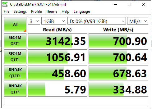

I have attempted Windows installation and it proceeds without any issue. This confirms that the issue is not related to the system. The settings are also the same as mentioned
  • ASPM is disabled
PCIe Link SettingsASPM Support Disabled
Moreover, I've taken READ/WRITE benchmarks as well for the drive.
Benchmark from Windows

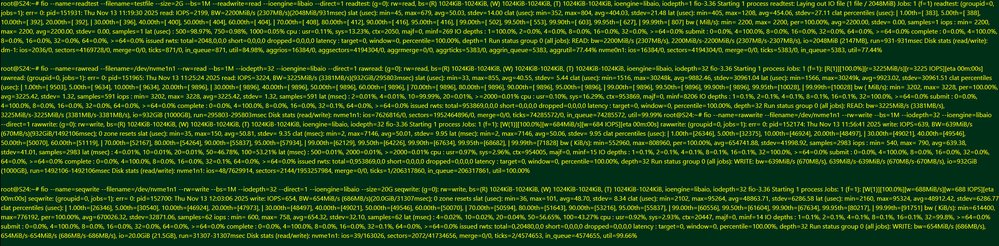

Also before proceeding for Windows installation, I was able to get the disk benchmarks from the Linux (The Linux that was previously installed was done by removing the Intel U.2 drives, installing on M.2 NVMe onboard and plugging the drives back and reboot).
Benchmark from Linux
The installation just hangs and proceeds very slowly as shown below due to I/O timeouts.
Errors while Linux installation
