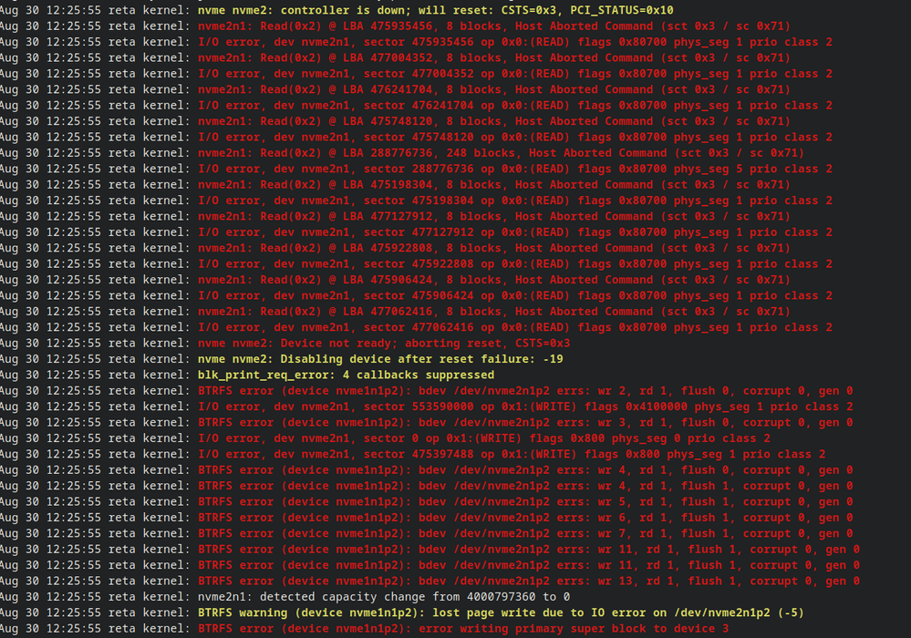

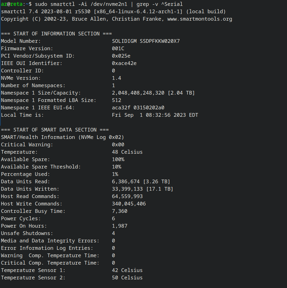

NVMe (P44 Pro, model SSDPFKKW020X7) sometimes just disconnects and stops working, smart(attached) reports everything being normal, temperatures are also within reason (around 45-50C, graph of a few minutes before the incident attached). Drive disconnects after about a week or two of uptime (although it was fine for the first month and a half of use). OS is arch linux running kernel version 6.4 (and a few older ones, but this is for the most recent occurrence).
Firmware is on the latest version (checked with the update tool).
I removed the serial number from my smart output (just to be safe), but can send it if needed.

Tempurture of nvme drivekernel logs of  drive disconnectingsmart output of drive after rebooting
