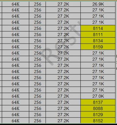

I have some new Solidigm SSDPF2NV307TZD drives on hand, when I try to ensure the performance on each drive, I found some drives are with strange random write performace, below is a table to show the test result.
Each row means different SSD drive, total 20 drives, 3rd column means random read result in IOPS, and the 4th column means random write result in IOPS, as you can see, 8 drives are with strange random write performance.
Because the 20x drive physical slots on the Server platform are with PCIe gen3 x2 but not x4, that's why the performance number did not meet the maximum performance that SSD supported, but it should at least with ~27k IOPS on this platform.
Environment

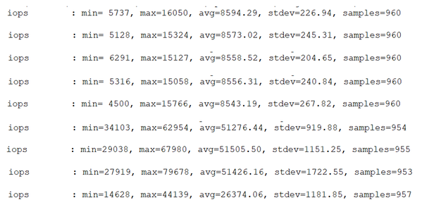

Update, have tried to run the test again with same FIO parameters on another Server platform which supports PCIe gen3 x4 for each SSD slot, and below is the result.
As you can see, different SSDs got different result, and seems the range is very huge, 8k, 26k, and 51k, believes that 51k should be the normal one.
I have also tried different vendor of SSD on the same platform, but did not see the same problem with same test environment and method, that means, the issue is not platform dependency, seems is related to specific SSD drives.
Please advise what is the possible root caused and how to resolve the issue?
Again, the SSDs are new.
