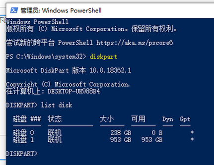

现在是已经用原来的SK hynix启动系统,并安装了Intel SSD。我怀疑 Microsoft Storage Space Device不应该存在,已经将其卸载:
在intel ​ssd tools box 里面除了不能固件升级外,其他正常。
运行powershell​

  1. I can't translate what is written on the image. However, I can guess that Disk 0 is the SATA drive, while the Disk 1 is the 7600p. It's looks that all space on this drive (953GB) is unallocated = free? Did you installed Windows as I suggested in my post?

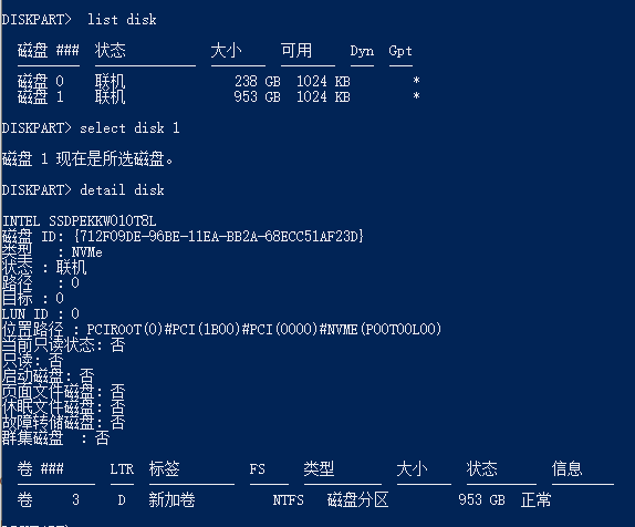

  2. Please run again diskpart in Admin PowerShell. Next run list disk and then select disk 1 (I'm assuming tat Disk 1 is the 7600p drive). Now run detail disk .

我做了检查,情况如下:
1、确实如你所说,Disk0 是 SATA,Disk1是7600P。看见未分配可用空间是953G,可能是我刚将Microsoft Storage Space删除,所以有953G自由空间。
我按你说明的步骤制作过7600P的启动盘,包括拔掉SATA硬盘仅留7600P安装WIn10,但是还是启动不了,说找不到可启动设备。
我猜想原因可能是DELL 7050主板不支持单独Nvme硬盘启动,不是7600P的问题。
我现在也没有再要求7600P做启动盘的想法了,太麻烦了,算了。原来计算机启动时总是出现“扫描和修复”的提示,现在已经没有了,我很满足了。
